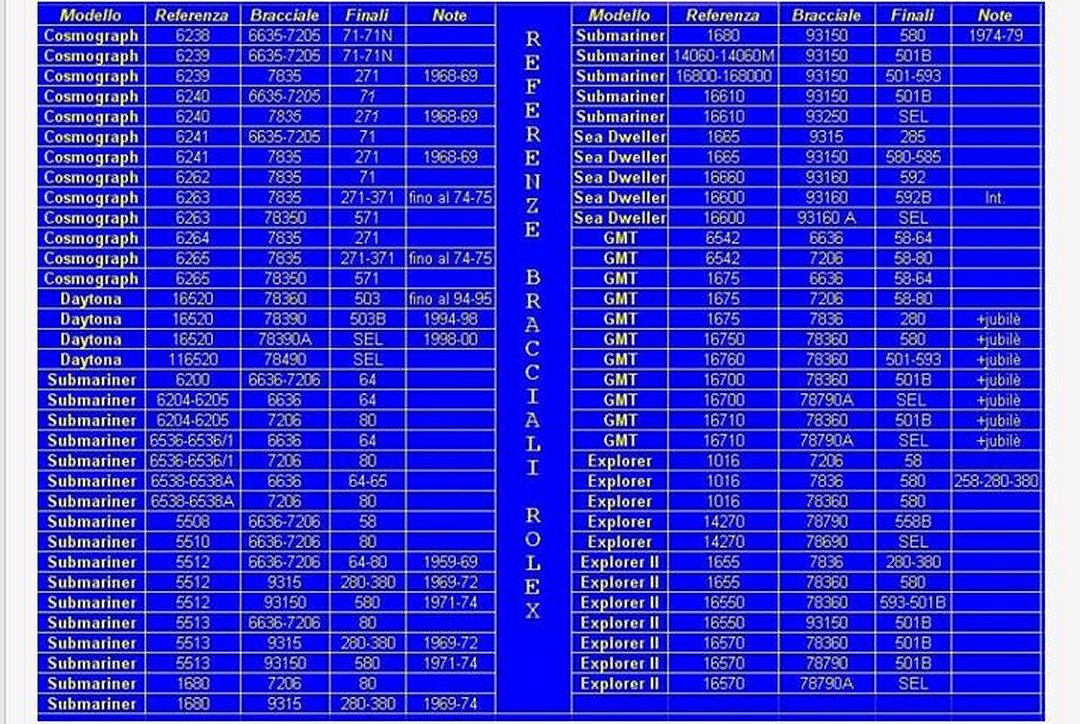

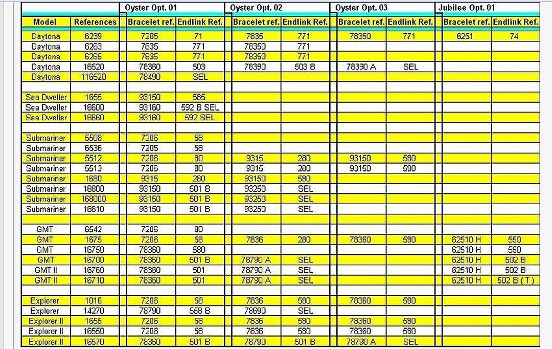

Below are a couple charts for the Swiss made end links indicating what fits a particular bracelet and/or watch.
